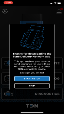

Initial Device Setup (Apple iOS)
1. Once the intital download is complete, click START SETUP.
